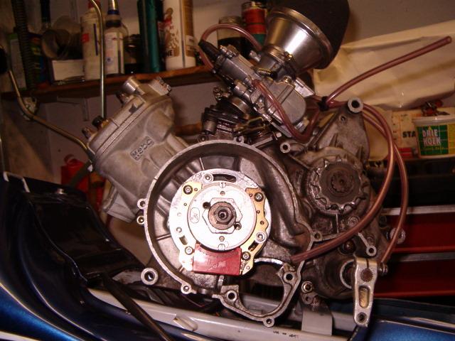

rs-power
Berichten: 519
Ouwe foto van me Blok OP me RS :P
blok!.JPG [ 54.3 KiB | 12360 keer bekeken ]
[5th Territory Tuning]
Retired Mod, BMW owner (H)
